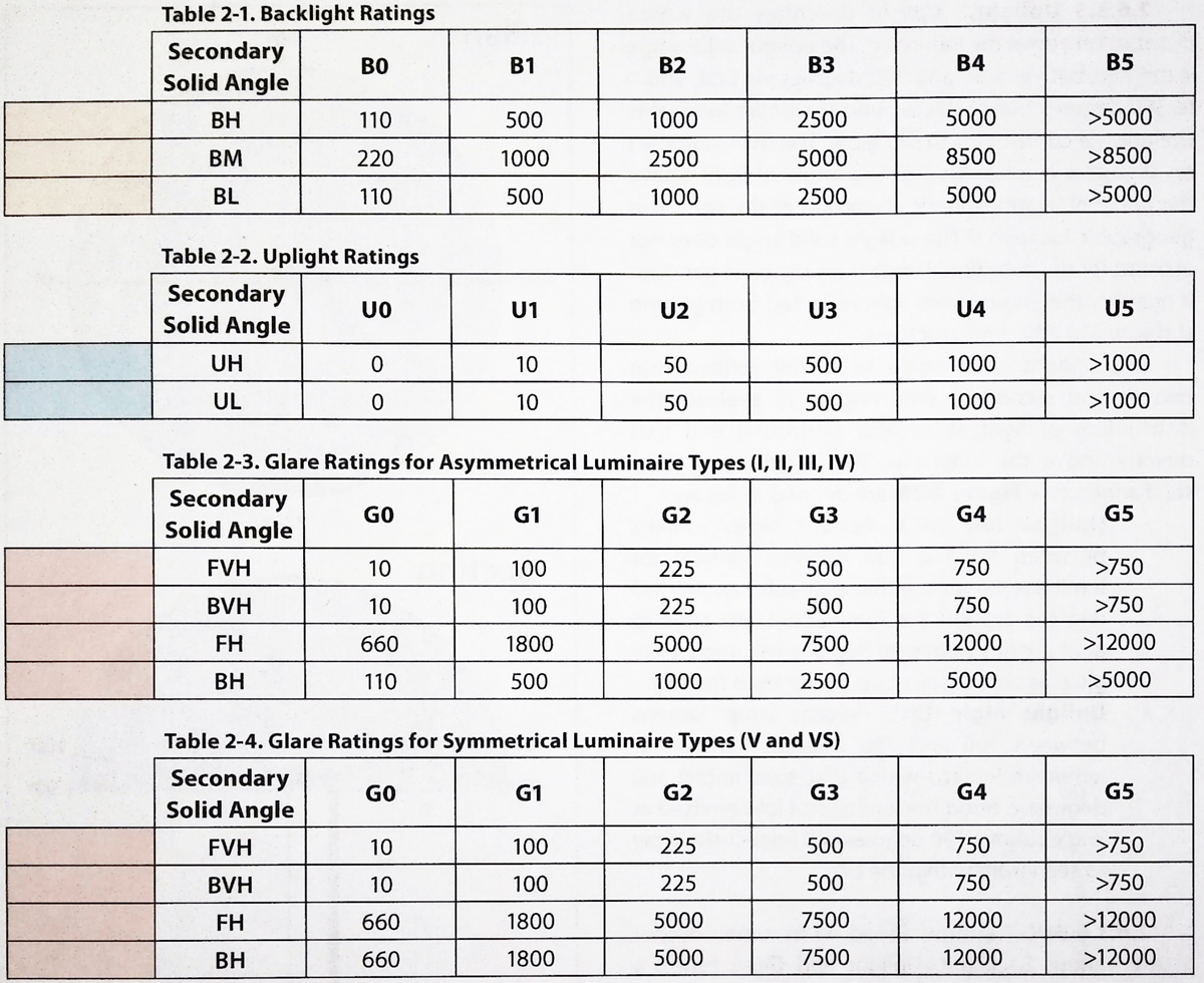

By comparing the lumen output in the various Backlight, Uplight and Glare zones to the maximum amount of lumens allowable on tables established within the TM-15-11, an outdoor luminaire is assigned a BUG rating. The BUG rating system allows lighting designers to evaluate fixtures for the amount of light emanating in all directions that may produce nuisance light.

BH and BVH secondary solid angles are glare zones in which the lumen output is accounted in assigning the glare ratings. The lumen output in BL, BM, and BH secondary solid angles is accounted in assigning the backlight ratings.
