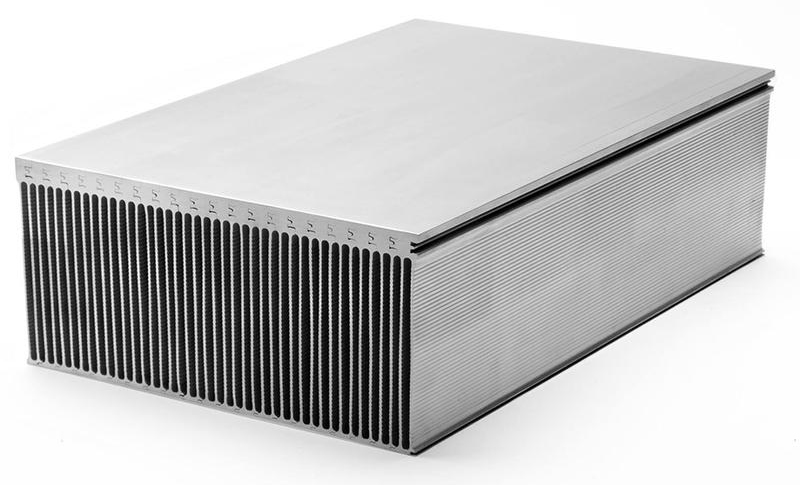

Bonded fin heat sinks are designed to maximize fin densities and depth so as to provide a high volume of convective heat transfer. The heat sink is constructed in such a way that a high density array of plate fins are assembled into a grooved base. A bonding agent, which can be a thermosetting thermally conductive epoxy or a solder, hold the plate fins tight in place. Despite the use of thermally improved bonding agent, there's still interface resistance between the fins and base. Bonded heat sinks are available with a wide range of material and fabrication options. Hybrid heat sinks combining different materials and metalworking processes for the fins and base can be accommodated by this solution. The grooved base can be extruded, die cast or machined. The plate fins can be extruded or stamped. Either aluminum or copper can be used to fabricate bonded fin heat sinks.
Skived fin heat sinks are carved out of metal blocks. Unlike bonded heat sinks which assembly plate fins into slots on an extruded or machined base and the fins are held in place by a bonding agent, there is no interface resistance in skived fin heat sinks as they're are constructed from a single piece of aluminum or copper. The skiving process enables a high aspect ratio (taller fins and higher densities). These thermal characteristics allow skived fin heat sinks to deliver high performance thermal management. However, skiving process is not an economically viable solution for mass production of LED heat sinks.

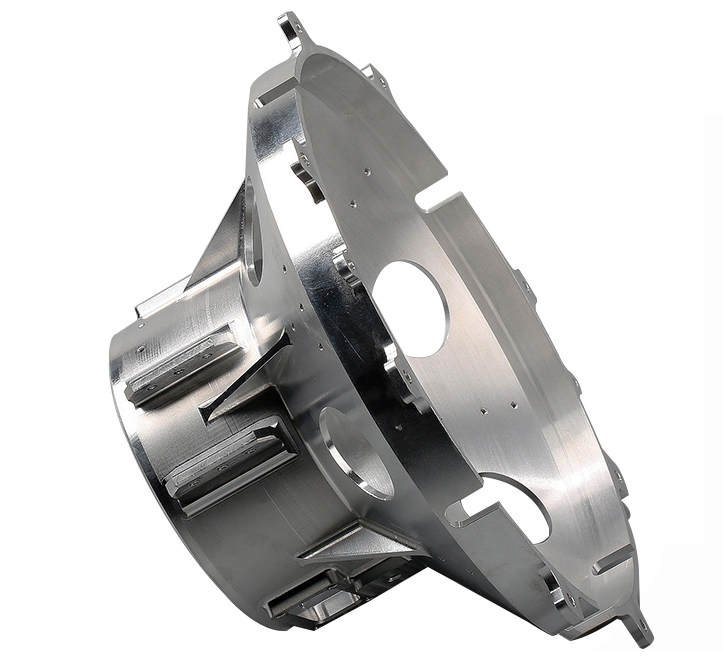

Machined heat sinks are similar to the skived type in manufacturing process except for these heat sinks are machined out of a metal block by gang saw cutting. Both the machining and skiving processes consume raw materials in an unproductive manner and are therefore less frequently used as LED heat sinks. The only good with machined heat sinks are their short lead time for small batches and high thermal conductivity as a result of low thermal resistance throughout the construction.
