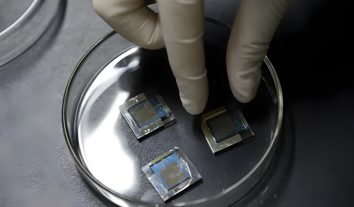

After numerous experiments, the researchers found that a polymer similar to plastic—poly(methyl methacrylate) (PMMA)—could act as an intermediary. By leveraging interfacial coupling, they successfully assembled monolayer graphene onto the perovskite film, achieving high uniformity and multifunctional integration. This breakthrough led to the development of a new generation of perovskite solar cells.
Professor Hou Yu explained that their study identified localized dynamic stress within perovskite materials as a critical factor in degradation, which they termed the “photo-mechanical degradation effect.” Under sunlight, perovskite materials exhibit significant photostrictive effects, expanding by more than 1%, which generates internal stress at the grain boundaries. This accelerates defect formation and performance loss in the cells.
Thanks to the superior mechanical properties of graphene and the coupling effect of polymers, the perovskite film’s modulus and hardness were enhanced twofold. This significantly mitigated the material’s dynamic expansion and contraction under light exposure. The graphene-polymer dual-layer structure reduced lattice deformation from +0.31% to +0.08%, minimizing damage caused by expansion and ensuring long-term stability under sunlight, high temperatures, and vacuum conditions.

To counteract this degradation, the team devised a protective layer akin to a "bulletproof vest" for perovskite materials. Using graphene—one of the world’s strongest materials—combined with a specialized transparent polymer, they created an ultra-thin protective layer measuring just one ten-thousandth the thickness of a human hair. Laboratory tests confirmed that this protective layer doubled the material’s resistance to stress, reducing its expansion rate from 0.31% to just 0.08%, akin to adding shock-absorbing packaging to fragile goods.Thanks to the superior mechanical properties of graphene and the coupling effect of polymers, the perovskite film’s modulus and hardness were enhanced twofold. This significantly mitigated the material’s dynamic expansion and contraction under light exposure. The graphene-polymer dual-layer structure reduced lattice deformation from +0.31% to +0.08%, minimizing damage caused by expansion and ensuring long-term stability under sunlight, high temperatures, and vacuum conditions.

After extensive testing, solar cells equipped with this protective layer set a new record: maintaining 97% efficiency after operating continuously for 3,670 hours in simulated real-world conditions of intense light and high temperatures. This is the longest stable operation reported for perovskite solar cells, bringing them closer to real-world application.Beyond providing a practical solution, this research has also reshaped scientific understanding. Over the past decade, global researchers have primarily focused on improving perovskite compositions, but the ECUST team was the first to identify “physical damage” as a hidden degradation factor. Experts believe this work redefines stability enhancement strategies for perovskite solar technology.
