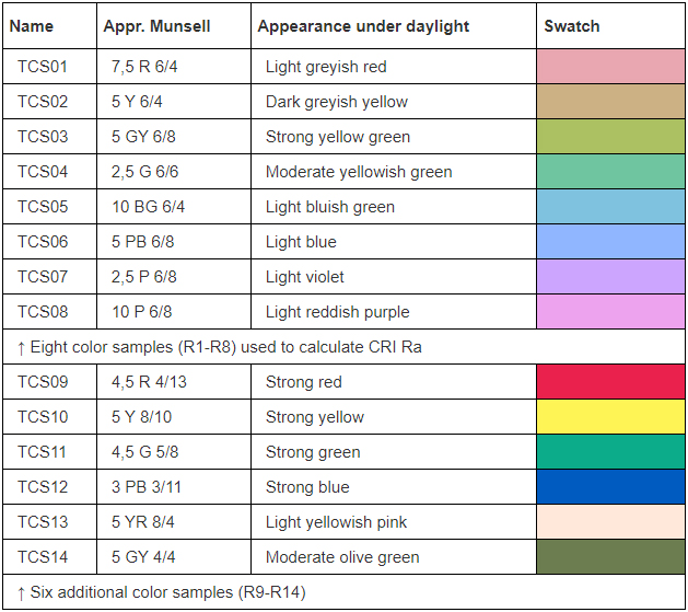

The principal metric of the CRI system is the General Color Rendering Index, which is referred to as Ra. In common practice, "CRI" is used to refer the General Color Rendering Index value. So whenever "CRI" appears in lighting literatures, one can be certain that it means Ra. Ra averages the Ri scores for the eight standard test colors. The colors that make up the Ra are the first eight color samples—TCS1 through TCS8. An Ra score of 100 indicates that the source renders colors in a manner identical to the reference. Daylight has the highest CRI of approximately 100. Thermal radiators i.e. incandescent and halogen bulbs have a relatively close CRI of greater than 95. Fluorescent lighting achieves a significant improvement in luminous efficacy but, to a large extent, at the cost of compromised color rendering performance. The typical Ra of cool white fluorescent lamps is in the 70-80 range.
Administered by the International Commission on Illumination (CIE), the CRI system is currently the only internationally-accepted metric for assessing the color fidelity of light sources. However, the CRI score is not comprehensive. It only contains measurements for R1-R8 values which are for colors with primarily pastel shades. The special color rendering indices for additional six saturated samples, commonly referred to as R9 through R14, are not included in the CRI calculations.

Among the Ri values for six saturated test colors, R9 is particularly important as it shows the response with deep reds. Without the vibrancy that comes from this critical color, objects with strong color tones will appear dull, unnatural, or unflattering. Therefore R9 is listed individually as a supplement to the general index Ra when faithful color reproduction with artificial lighting is of paramount importance. R9 values above 75 are often required in museum, photography, retail display lighting applications. An R9 value of 25 is considered as good for residential applications.
