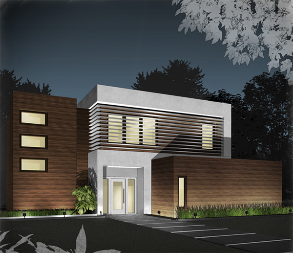

Wall washing is a landscape lighting technique for evenly illuminating a wall or large vertical surface. The broad, uniform illumination hides imperfections and flattens the appearance of the illuminated area. Wall washing is accomplished by placing light fixtures with a setback that is distant enough to avoid bright spots while allowing the lights to evenly illuminating a wall from top to bottom in a smooth, graded wash of light.
Image courtesy of Kichler
